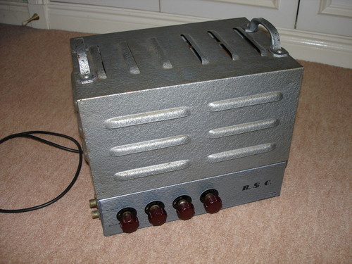

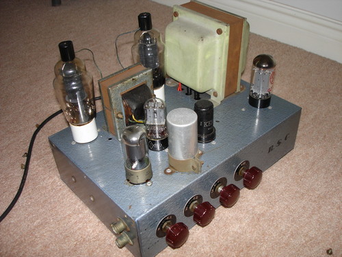

Может, для коллекции?...
Very Rare Vintage 1950`s RSC A10 Valve amplifier made in Leeds in the UK approx 1956 it`s the predecessor to the Linear Conchord.Fantastic condition for it`s age and in excellent working order.Except for a Brand New JJ GZ34 rectifier and 6SN7GT eq phase splitter valve several NOS mustard capacitors and a new mains lead it is completely original and in excellent working order.Comes with it`s metal base plate and louvred cover.The last picture is of an original advert in the Wireless World February 1960 (slightly later version) when it cost 11 gns - £11 and 11/- shillings.This is only for the UK as postage will be expensive due to it`s weight.
